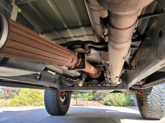

It will absolutely help your issue, but you will have to measure during installation. The kit provides 3 spacers on each bolt of the drop kit.
You might only need 1 or 2 spacers on each side vs the full 3.

I forgot to mention the 3 spacers ... but I am pretty sure he is going to need all 3 regardless ....
