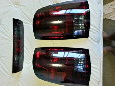

Finally got around to doing my tails. I just need to Wetsand and polish now, I was even able to debadge between coats.

Thanks man, that's just one coat.

Looks good. I didnt wet sand mine when i did them. Just two coats on the tails and third. And one light coat on the headlights.

I put 4 coats of clear on mine, i always wet sand the orange peel out with 3000 grit followed by a compound polish and then again with a finishing polish.. gives them a deep gloss look.

Looks good! I did smoked tint on my third brake light to match the slightly smoked oem Sport tails, came out better than I thought! Was going to go with the darker but then decided to keep it more oem.

Looks great. Last set I did I put on 5-6 coats of clear and wet sanded, then polished. They looked amazing! Can't wait to see the finished product!!

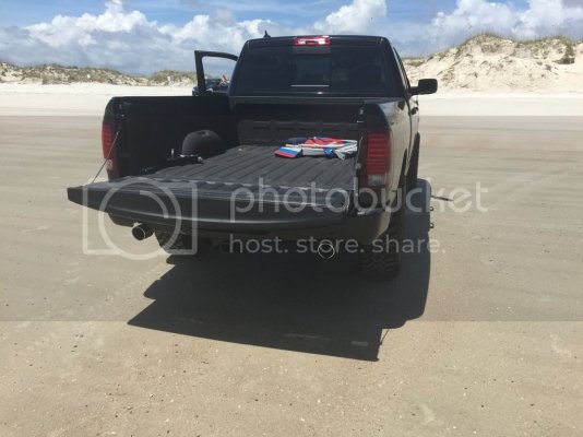

Sorry to drudge up an old thread, but how is the VHT holding up? I've read rumors of fading, even with clear coat.
I want to put a light smoke on my headlights and tails.
What's the general consensus, one coat for a light smoke?
Last question I swear, what brand clear coat? Just a rattle can?
a4954e31bc70bf3eccf1321feea89a94.jpgthats two coats of night shades. Been about 10 months. Haven't noticed fade yet.

I didn't clear them. But I will when I get a chance. They kinda orange peel.

No. they holding up good though. A lot of people do them with regular clear mixed with black. Then put clear over that and rub them out. I would like too. Just so they look deep and shine like the paint does.
