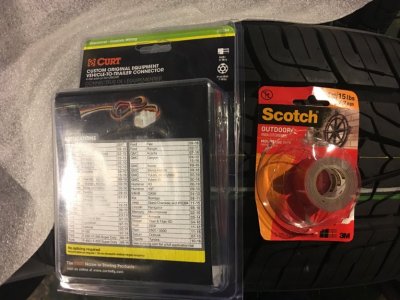

Ok, here are the 2 things I used to install the bar. The tape I had left over and the CURT trailer harness adapter. This thing is sweet, it fits between your stock plug and then plugs into the stock bumper, then it has a extension for a 4pin trailer plug which plugs into the LED bar. All made in the USA and great stuff. Plug and play with no cutting. The reverse light is the only external connection I had to make, I just tapped into the center port of the 7pin trailer plug on the CURT harness and was done. So now I have full access too all my trailer plugs in the bumper and the bar will still work, no cutting and no wiring mess as it's all behind the bumper and tucked out of the way.
CURT - 55384

Where did you tap into for the functions?

can you show some pics how its wired? i have the tailgate lightbar sitting in the garage and i cant figure out how to wire it

I used the curt adapter in post 7 of this thread. It's plug and play and it comes pre wired for a 4pin trailer connector. U just plug the OPT7 plug (trailer 4 pin) into the curt trailer 4 pin and your done. The only external connection is the reverse lighting which they supply the wire. I tapped into the middle of the 7 pin connector which if you look on the bumper of the ram on the 7pin trailer plug cap you'll see the middle terminal is labeled R with a headlight icon. This stands for reverse light. Choose your tap of choice and connect into that. I decided to tap into the curt harness vs the stock wiring.

Look at post 7. I provided a pic of the adapter and the part #.

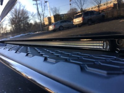

Here is a pic of them during the day.

... The LED bar covers the tail gate access hole for the spare tire, I tried to install it but the plastic hole cover wouldn't let the bar sit flat. I removed the plastic cover which is just there to protect the paint if u need to get the spare out. I can clip it back on in under 15s if needed. But the bar lays flat and straight without it. 2.5 years and never needed the spare so... knock on wood!
Really want one of these, but not having access to the Spare tire port seems it could be an issue. I've only ever had to swap on a spare once, so its a very rare occurrence. But I'd hate to have to rip off these lights to get the spare off.
Any lights out there that clear that access port?
