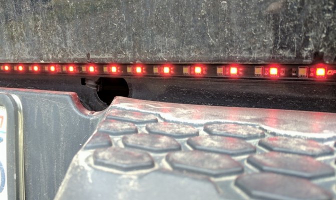

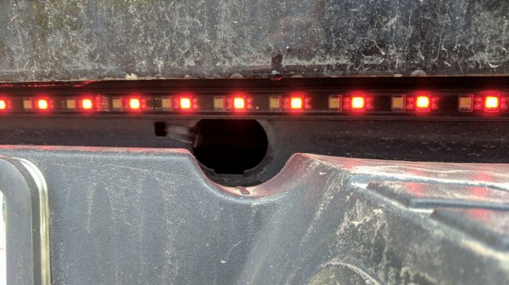

I just installed the OPT7 bar last week.
I removed the plastic grommet around the tire access hole and installed the light bar so the bottom edge is on top of the spare access hole.
The light bar is still perfectly visible from the rear, it's just when you are up close looking down that the LEDs aren't directly visible.
The kit comes with clips if you want to drill and mount the clips. This makes the light bar easy to remove and you can mount it lower than I did. Perfectly happy with the location I used though.

Do you still have access to lower the tire without removing the bar?

Yes the light bar does not cover any part of the spare tire access opening. I can post pics later but it's pouring down raining right now.

Really want one of these, but not having access to the Spare tire port seems it could be an issue. I've only ever had to swap on a spare once, so its a very rare occurrence. But I'd hate to have to rip off these lights to get the spare off.
Any lights out there that clear that access port?
I dont think you understand. the bar has brackets that clip onto it. The brackets are designed with a hole for a screw to screw the mounts into the bed. You dont have to screw it on... I have used the 3M tape to hold it to the truck very strongly. The bar will simply unclip from the clip mounts allowing full access to the spare tire. Then you can clip it back in when done. You can also permanently mount it or drill holes and do the strongest mount with the screws if you can prevent rust.

I think you might have an issue. WHen I mounted mine up that high the first time when the tailgate was fully opened it hit the bar and ripped it off the tape. You need to verify the tailgate doesnt hit and I can't image it wouldn't as thats why I had to lower mine to clear.
Uh oh...... crap, I need to check that clearance. Thanks for posting this as I haven't opened my tailgate since installing. Hopefully this will save me any headaches.
I'll report back....

Haha yup! I can guarantee that your going to contact if yours is any higher than mine is. Mine barely almost rubs when opened. I would open it very slowly and watch from the inside of the bed area as you wont be able to see under the tailgate when almost fully open. the tailgate moves down and then inward considerably during full opening. I was so shocked that it contacted the bar when it was centered between the bumper and bottom of the tailgate. I then had to line the bottom of the bar with the top of the bumper and it barely clears.
I just installed another one on my neighbors 3500 and I was sure to mount it this way as well. But he might have alittle more room being a 3500. The tailor plug was also on the other side of the license plate.

Ok....short version, no clearance issues. BUT I failed to read your first post to see that you have the new version of the bar that takes up more space.
I'll post notes here in case anyone is looking for an alternative solution. The bar I ordered is here:
https://www.amazon.com/gp/product/B00Z8TGR4G/ref=oh_aui_detailpage_o01_s00?ie=UTF8&psc=1
I used a slightly different CURT adapter that gives you a 5-way flat behind the bumper to tap into for reverse....just one more option that works on our trucks:
https://www.amazon.com/gp/product/B007EA6WQU/ref=oh_aui_detailpage_o00_s00?ie=UTF8&psc=1
This combination can be installed and maintain access to spare tire as shown with no clearance issues with tailgate opening. As stated earlier, the plastic grommet for the spare tire access pops right out and can be saved for later use:
This company makes good quality products and I'm happy with the light output and functionality.
