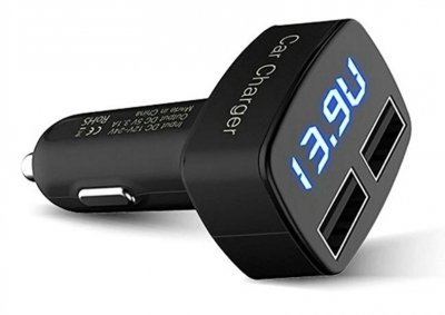

exactly what I have. located within the upper console or "Back of Jumpseat" ordered off of Amazon- here is the number
Roll over image to zoom in
MOPAR 68096426AD - Media Hub 08
3,058,563
170,670
