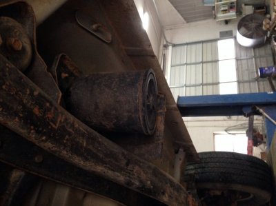

What's is this canister

Charcoal canister for the tank venting system.
There is a more technical name for the system, but I don't feel like remembering it right now. lol

Not that I know of. It will make the PCM throw a code and can possibly cause the gas tank and fuel pump issues.
Why do you want to delete it?

Doesn't seem to be mounted well like it's just dangling I guess I'll rivet a strap for it does it have to be straight up and down or can it be sideways

I'm thinking that there should actually be a box for it. At least there is on my truck. The box doesn't support it, but it keeps it from getting whacked quite as bad.
