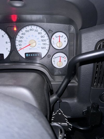

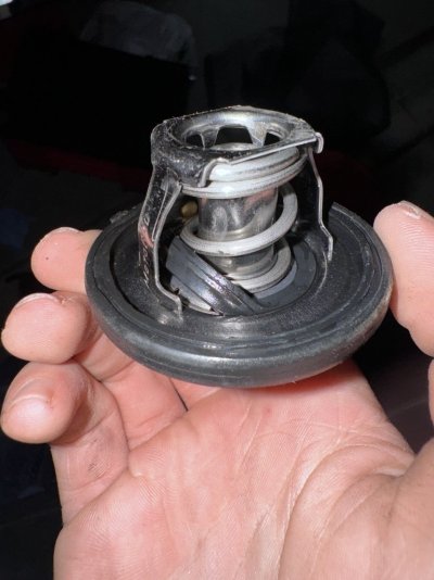

I’ve got a 2003 Ram 1500 4.7 with about 112k miles. Through the last year I’ve replaced the radiator, coolant reservoir, water pump, fan clutch, and thermostat and had no issues after replacing them with new coolant added each time. Recently I encountered an issue where when the truck sits in a parking lot, the gauge shows that it heats between operating temp and high temp, as well as the ac gets a little warm. However, once driving the temp comes back down to operating temp and the ac cools off. I was instructed by others I know to replace the thermostat again, I found the thermostat to have a faulty seal so I replaced it as well as the thermostat housing. It can maintain operating temp while driving but again while being parked for an extended amount of time the temp has climbed a little over operating temp but will come down if I bring the rpm’s up. I will conduct further testing tomorrow in the hear. I will attach photos of the current temp while parked at night as well as the previous new faulty thermostat. Any help would be appreciated kindly. Thank you

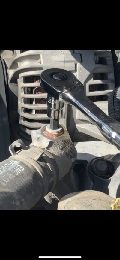

Went ahead and bled the system saw small amounts of bubbles come out the bleed valve. Saw some larger ones come out of the radiator hose connected to the reservoir. Doesn’t over heat anywhere near as much but i did catch it creep just past operating temp at idle. Brought the rpm’s up and it climbed back down to operating tempView attachment 549354
