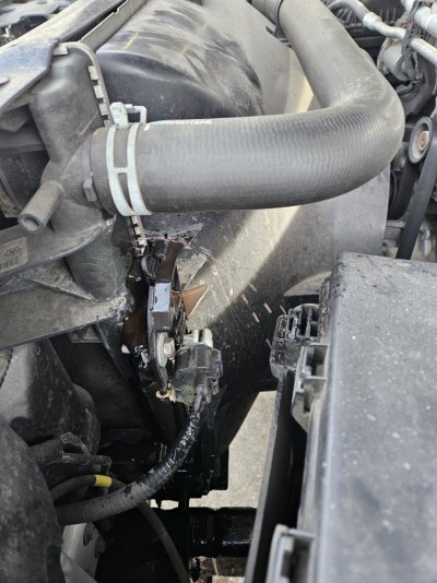

I have seen/heard of 7 or 8 now (including mine) that cracked on a seam in that very area.
Mine decided to fail 12 hours before an 800 mile road trip. That would have been a huge bill if it failed on the interstate out in the middle of BFE somewhere.
Mine after filling with 15 psi pressure test.
Replace the radiator, don't chance it.
