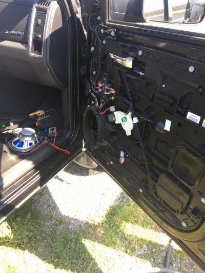

Wait , wait , wait... youre tapping wires for the sub from the factory alpine system?
You need to tap the rear door speakers, or before the factory amp.
No telling what signal processing is done on whats going to the Sub.
I just discovered this issue with my install this morning sounds good at any thing below 20 soon as you turn it up sounds distorted and was popping. Will the back door speakers work? I’m currently going to the fronts as I understood they are a true full range? 4fc83ed41ac70d63b3f90c9ad9606eb4.jpg
adrianp89
Sep 3, 2015
3,179
1,277
Tampa Bay, FL
Going to the sub is 100% perfectly fine. You do not gain anything by going to to front or rears, in fact you lose signal. This has already been proven based on RTA measurements.
Sounds like the speakers are clipping and you are pushing it past it's limit. What is your gain? Is your amp signal set for low or high?
