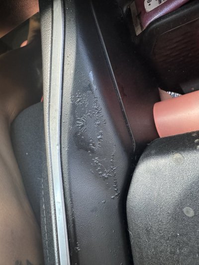

On my center console and steering wheel the paint is bubbling and peeling. Iv had nothing but problems with ram. Yes I use sunshades, anyone elese have this problem?

Those pics are confusing? Why would the dash and other plastics be painted? Did it get coated with some sort of plastic treatment which is now coming off? The button one admittedly looks like paint peel, yes.
I have had four rams now of various ages. Never seen this. Bubbling dash plastic/leather yes. I didn’t even know they painted these parts. Thought it was colour injected at manufacture

Have you cleaned it with something other than soap and water ? If so , whatever was used may be the cause.
I don’t recall seeing this before , on this site.

i had this exact same issue and it was caused by my wife who had put a glade pl;ug in in my 110 volt plug and everywhere that **** got the paint bubbled up just like yours wonder if some cleaner or spray maybe something on your hands or clothes reacted with it? but your pics look just like mine did
