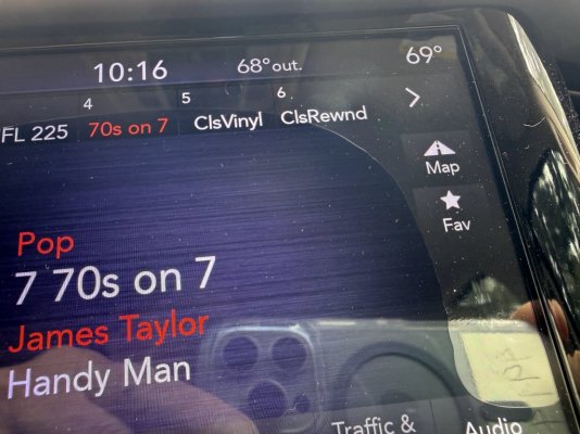

2020 Laramie 4wd diesel dually - just wondering if anyone else is experiencing this seeming bleb developing on their center console touch screen. It looks like a cellophane protector covering coming loose but appears to be under the glass. The touch screen works perfectly well but the problem seems to be slowly spreading.

Hello, You have a delamination issue. You need a new LCD screen. The liquid behind the glass is UV Loca glue. It will continue to get worse and become very messy. The liquid is very sticky, almost like syrup. Common issue in Ram and Jeep Grand Cherokee. (They use the same screen) Send me a PM and I can help you getting it replaced.

I am having the same issue with my 2019 ram 1500 I just purchased the truck used from a dealer and they won’t repair it.
