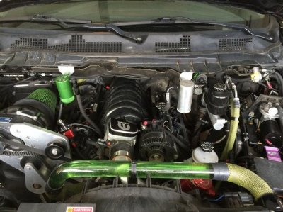

Recently I was looking around at modes that I could do to my engine bay to make it look a little cleaner and show better. I came across pictures that Challengers posted and they have painted their intake manifolds, they look great. So I was wondering if anyone here has done it and if so how hard is it to do and what kind of paint would you use to paint it? Do you need high temp paint or would just a normal automotive paint do the job? If anyone has done it could you post pictures and maybe a video or step by step for the process.
Here is a sample of what I've seen that has caught my eye.

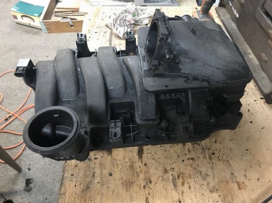

This is what I started with

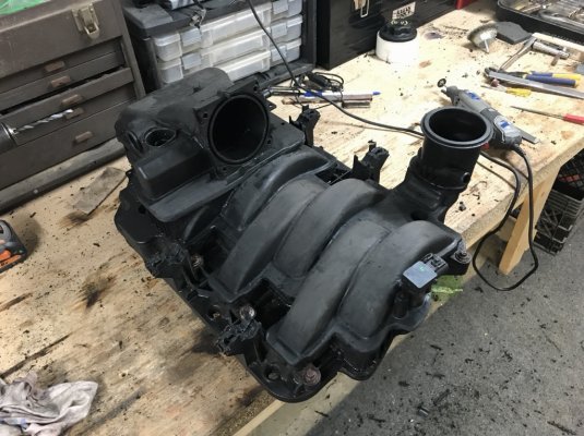

Started shaving off whatever I wanted with a dremel
Now I have to find some kind of a filler to smooth over all the dips and dimples left from the dremel. It takes a smooth hand to cut stuff out. There’s also a lot of small spaces to get into to clean all the oil and hunk out of before painting. For painting I’ve read about using a high build primer to help smooth it out
