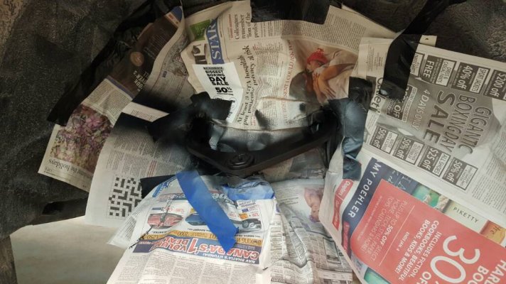

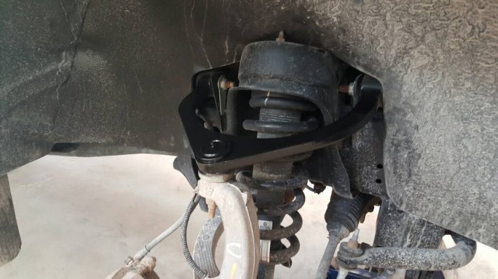

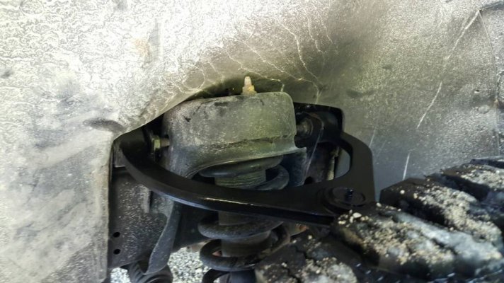

I couldn't take the rust on my Mevotech UCA's anymore so I painted them!
First I took off the tires and took a wire brush to them. Then I took sand paper and scrubbed the hell out of them lol. After that came paint.
I used 2 coats of Tremclad primer, 2 coats Tremclad flat black paint, and finished off with 2 coats of clear coat.
Before:
Primed:
Painted:
Finished!
Turned out great! They look better than new. Hopefully they hold up!
