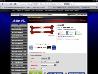

Are these them?

Yes. They made the first set for me. The pics of how they center the wheels are my truck on their site.

Those are the uppers, they have the lowers as well. You can save a few bucks, and buy their "kit" that includes uppers, lowers, and panhard rod. You can check in the "4th gen DIY "section on this forum for some direction to help you with this job.
