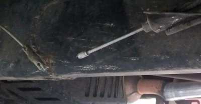

What is this cable on the driver's side that runs the length of the truck...except for where it seems to have pulled apart? Parking brake?IMG_20200912_110519_1600217949188.jpg

Yes, that's the parking brake. You should be able to re attach it. You may need to adjust it or try to figure out why someone decided to disconnect it. Possibly because it's not long enough if the truck is lifted.

Yes it is lifted. I'm having the rack & pinion replaced this weekend so I'll have 'em take a closer look at the parking brake as well.

Yeah, it doesn't look like it's missing any of it's jiggly bits, but it may have been disconnected on purpose.
Not sure of your location, but it's not uncommon for the parking brake mechanisms to rust solid at each rear wheel in as little as 2-3yrs from new if you live in the rust belt. I've got some threads and posts on how I've freed them up in the past.

On my 2016 the cable became so loose, or something broke, last year that it hung below the frame. I tightened the cable and it seemed to be mostly happy after that. I didn't inspect the mechanism at the wheel as I was trading it in soon and it worked, but for that much slack I fear something was not right as it was a lot to be a sudden cable stretch. I'm not just in the rust belt, I'm pretty sure we wear that belt with pride in New Hampshire; we like salt and pre-treating the roads like crazy.
