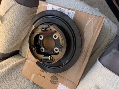

After 93k miles I finally needed to replace the brakes on my 15 ram 1500. I’m guessing that they were the original pads. I bought the truck from the dealer with 20k on the clock. It was the owners wife’s vehicle.
what we found when we removed the left rear brake rotor is the parking brake pads & hardware completely missing, the hardware & pads were installed on the right.

UPS just dropped off the missing parking brake parts
thanks for the responses
