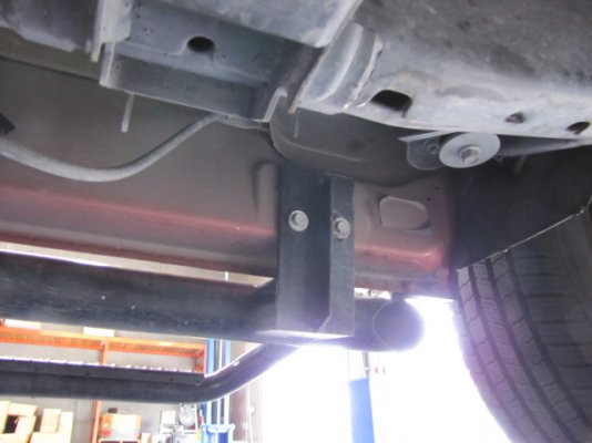

Does the cable in these images SAG ?
There should be star wheel adjusters with a rubber plug in both rear backing plates, a bit of penetrant squirted on the adjusters may work something loose

If you look where the two cables go to one, there is a nut on a long threaded rod. That’s the adjuster for taking up cable slack. I would start there.
