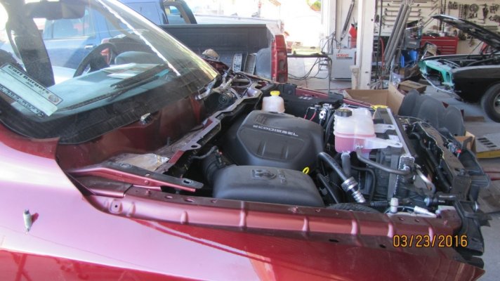

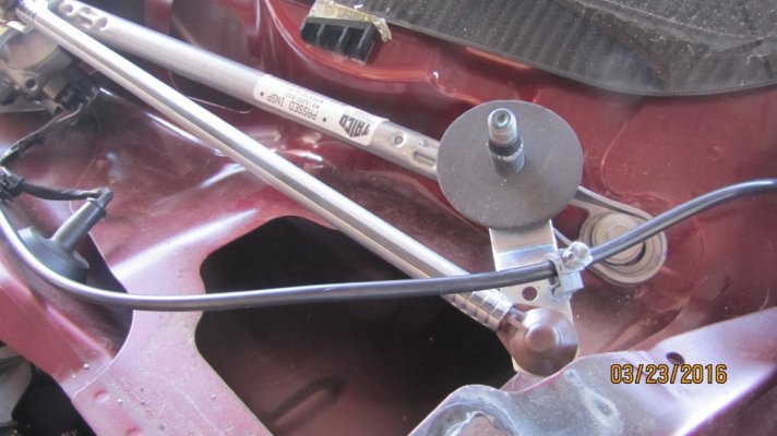

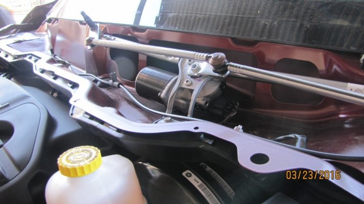

there is nothing to stop rain water from entering into the Inlet for the HVAC System
On my Ram the big opening was taped closed
