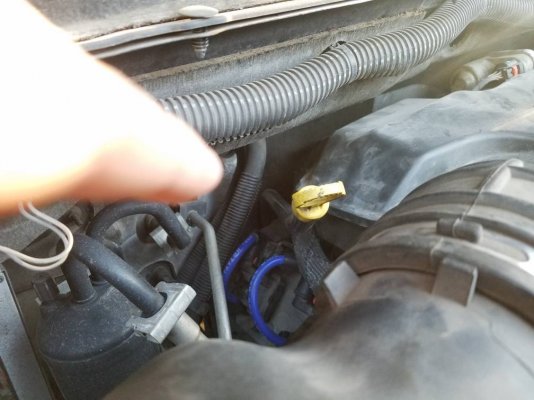

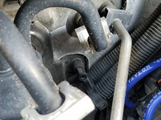

I would also like to point out that while I was under the hood I happen to move a few tubes two of which go into the firewall. The reason why I moved these two was because I noticed a plastic piece seemed to be designed to slide over a screw that poked out from the firewall.
The two tubes were disconnected from said screw and hung freely, so I thought to rectify the situation by pushing the plastic piece back over the screw. Could this in anyway have caused or catalyzed the issue?(pics below)

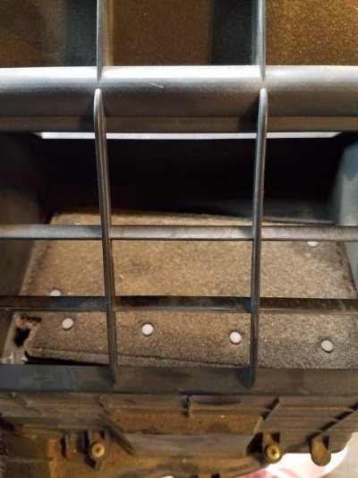

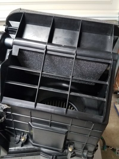

That crack was most likely the sound of the recirc door breaking and falling off. The blower is right under neath the recirc door and the door is now on top of the blower, blocking air flow.
This was my broken recirc door:
This is after it was replaced:
No, this would not affect the recirc door failure.
