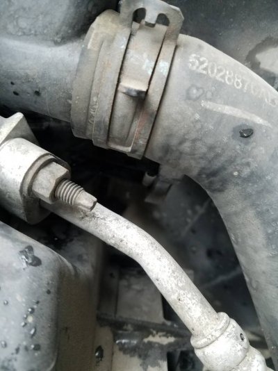

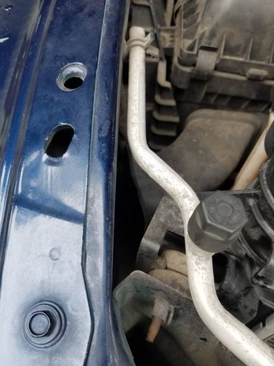

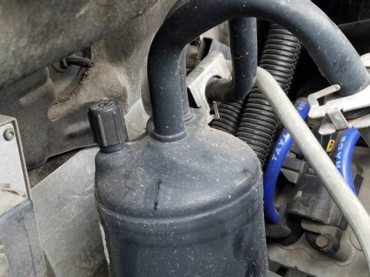

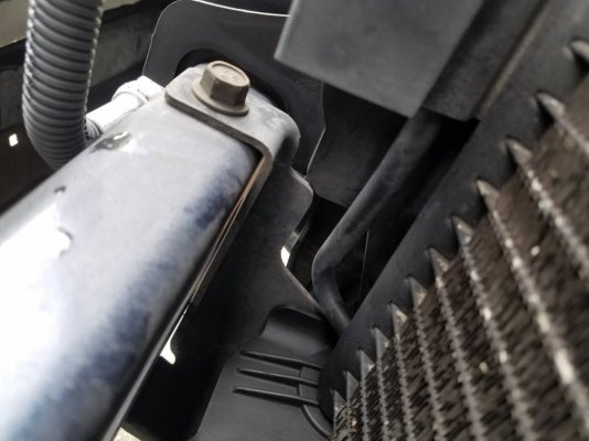

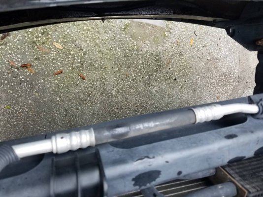

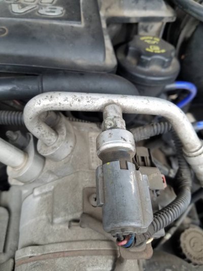

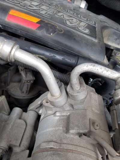

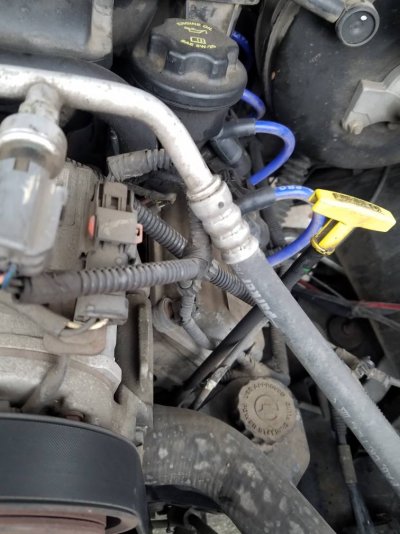

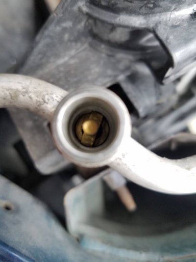

I could only check one valve. There's not enough clearance to get to the other one. The one I checked seem fine. No wiggle in the stem thing. A tiny depression causes as hissing sound. Seems like it's sucking in when I do that.
Doesn't look like I can spot an outright leak, either. Here are some pics. a21363e31f8d98c78fd07b6f70b1895c.jpg438c3d220797633fca4e3eded275346d.jpg6888df84ccf35e22ea6819a0c101b84b.jpgab961c66f1180f715951a47994f570de.jpg1234c381630ea57c0f4cb6df975ed70a.jpg8f31c17ce09b88fdc8ef828141255964.jpg3c53c9db9493a3c6656ec772448a3500.jpg6e787379f3947cd4ad26317c8592743e.jpgf77be5b6e47ef09c91f530a037432303.jpg

I'm betting you don't have a leak and the whole issue is because of the recirc door blocking the fan, possibly multiple door failures.

But there's ZERO cold now, and if feels like HUMID air, and it SMELLS. Aren't those like, the number one, two, and three signs of being sans-freon? Especially when it still had SOME cold on one side and NO smell when it first went out???

the no cold on one side is signature of low freon, your leak could be small enough that you dont see anything, i had a leak on my old 06 that i couldn't find with dye, your leak could even be in the evap core, so thats where hopefully the dye will show you, i wound up using some amazing ass stop leak in mine that made it work perfect until i sold the truck years later

I'm hoping it IS in the evap core as I'm replacing that, anyway. Either way, I suppose I'll find out two weeks from Thursday. Or, if they can't actually get a charge in it because it's REALLY bad, I guess I'll find out ON Thursday. Lol.

if it was bad enough that they couldn't make it charge at all then you wouldn't have gotten any sound out of that valve you pushed, the one you pushed is the high pressure side so that means your system isn't fully empty yet
