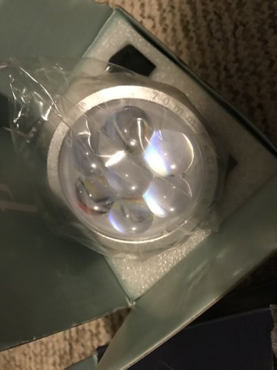

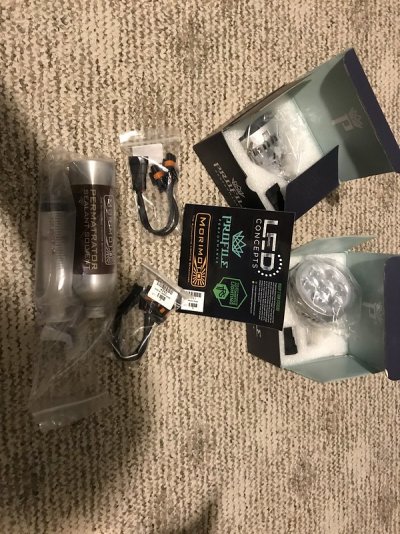

MAIL CALL!
Got a new set of quad headlamps in to open up and create the Frankenstein headlight. Got to clean the lenses and work on ripping them apart.
Ordered some Morimoto permaseal dissolver to aid in the process, will give it a go and write a review if it makes it easier.
I also got word that the free black Friday etching is being done tomorrow and will ship shortly after that for the HID kit. Very excited to have everything on the way and get this started.
Photos!!

Took some time yesterday to read the Morimoto permaseal dissolver and am unsure if I even want to look at it. The warning on the label is enough to chuck Norris a little concerned. Pretty much you need a hazmat suit to use it, in room with at least 60% humidity so you don't risk a spark. I will try to post a photo later this afternoon.

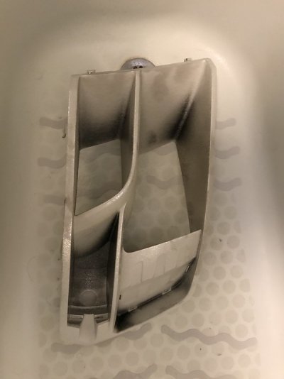

31404845697_4731347ab2_c.jpgBeginning of retrofit. by Black Additive, on Flickr
Ripped the head lights apart.
Test fitting.
31447828227_7eb2120fc0_c.jpgUntitled by Black Additive, on Flickr
46387229531_6423046bde_c.jpgUntitled by Black Additive, on Flickr
Box of goodies, harnesses etc etc.
44527329850_6171f239fb_c.jpgBeginning of retrofit. by Black Additive, on Flickr
Permaseal.....yum.
32472143748_57d4645c69_c.jpgBeginning of retrofit. by Black Additive, on Flickr
Easy baking the bezels. Need the HD forumla, as the regular did not cut it. Going to *** them to a shop to get painted as -2 degrees does do well with paint. :33:

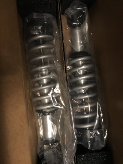

Got the Icon Springs in today, box was pretty heavy. I guess I never really thought about how heavy a spring would be....only a week left, cant wait.
I started to sort out the wiring and get the headlights mocked up to install. Hoping to borrow someone's garage for a few hours to get the wiring in and rotation right. Silly Mopar spec harness is going to be a pain to get wired up right while keeping the stock look.

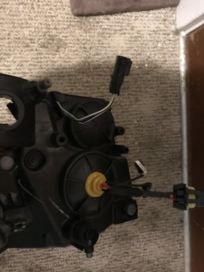

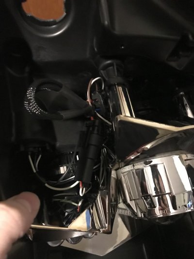

Got the wiring all set and sanded down the bezels a little. I decided to keep the factory reflectors chrome as an accent piece. I thought it would have been too dark otherwise. Weather warmed up to the lower 50s so I attempted to paint the bezels. We will see how that goes.
Headlights all wired up.
31473234417_1327d439ff_c.jpgUntitled by Black Additive, on Flickr
45500300335_167d95e4d6_c.jpgUntitled by Black Additive, on Flickr
45500300075_95688d7941_c.jpgUntitled by Black Additive, on Flickr
46412604601_d38e9e0561_c.jpgUntitled by Black Additive, on Flickr

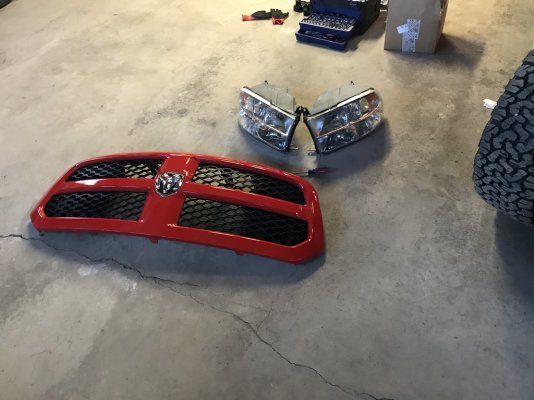

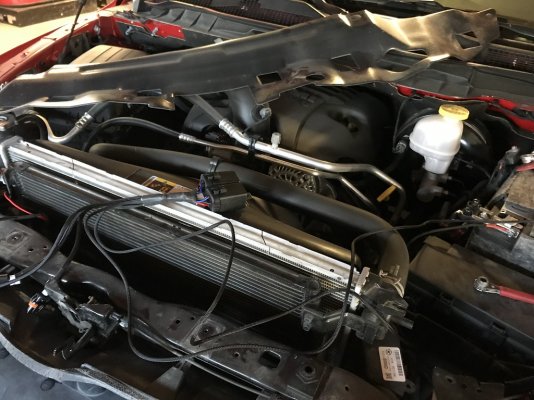

Grill and headlights off, ended up breaking the lower left tab on the grill. :(
45594148015_890fa4e372_b.jpgUntitled by Black Additive, on Flickr
Wiring things up. Was about 5 hours getting everything undone, wired up, trouble shooted as I misconnected a few along the way and getting everything rotationaly level.

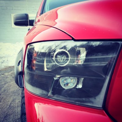

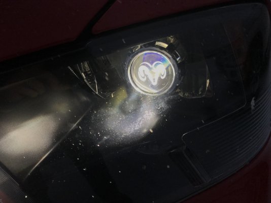

The final product, dont mind the condensation, its just because it was kind of warm when I installed it and it was about 4 degrees outside. lol.
45594144085_502122bc87_b.jpgUntitled by Black Additive, on Flickr

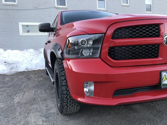

Body shot, have some spacers coming in the next few weeks to poke those wheels out a bit more. Should look pretty darn mean if you ask me.
