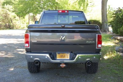

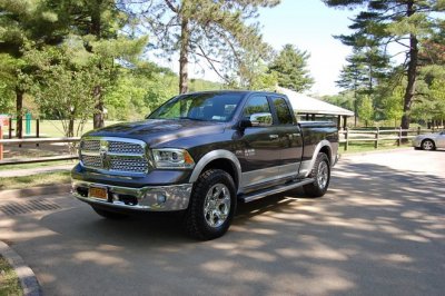

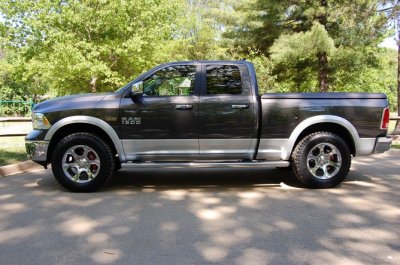

Hello All: :D
Well we're just back from the garage and I am very pleased. After the
Bilstein 2.1" level , Zone Offroad upper control arms , and Mufflex DOD 18
muffler, Ranch custom painted fiberglass tonneau cover , and some red brake caliper covers ,we were ready for tires. I chose Toyo Open Country AT IIs in the 295/65/20 but only ordered ONE to be sure all was well.....it was!!!!
So here is Phase one completed. I hope you like her and thanks to you all for your guidance with this project.
Dante :favorites37:
PS only one problem...The Ram is now so tall I cant see the painted engine
cover I worked so hard on. DOH

Looks good man
huff2462
Sep 8, 2013
175
68
Baltimore, MD
Awesome... didn't think those tires would fit. I like it!

Looks solid. I just put the same tires on my truck!

Dante221 what does 295/65/20 translate to for height and width? Also how do those tires preform in snow and mud?

Hi Cormier
They are 35.1" diameter and 11.6" wide
Since it is May, I will have to wait a bit before assessing their
prowess in snow :laughing1:

Hi Cormier
It's the width of a typical 35/12.5/20 tire that will get you in trouble....
the 11.6 width of the Toyos are OK
You may not need the Zone control arms on a 2011. From my reading its the
2013 and 2014 control arms that are giving trouble
