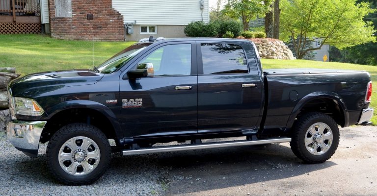

I am using a Traxda 1.5" spacer, which is almost level. Didn't want to take a chance on having any rear squat so this seemed like a good compromise. So far no issues and along with the Thuran's Fab front track bar it actually handles much better than stock IMO. I'm using 275/65R20's currently which is a 34" tall tire. If I purchased again I might go with a 285/65R20 which is a 1/2" taller (but 4lbs heavier as well).
