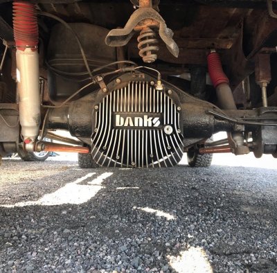

A couple things of note. The cover does not hang down any lower than the stock diff housing.
62075316_2714071758622888_2662058336794443776_n-jpg.172258
Sure looks like it hangs lower to me.
