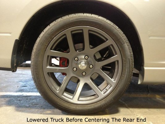

This is a 2009^ Ram 1500...a damned clean one at that.
That is the stock geometry...notice the bar is parallel to the axle. This starts the suspension in a neutral position which is what you want. You'll feel less of the horizontal movement when driving with the bar like this.
Now if you drop the truck and wind up with this like the old Bell Tech kits...you start having issues.
With the bar unlevel as the truck moves vertically the arc the bar swings in has to come down to the point of level THEN down past level which exaggerates this "wagging" feeling. Factor in the shorter, stiffer tires most of us run with a drop and you really feel it then. Even an adjustable panhard isn't going to fix the issue in this case...the bar being out of level is a main part of the issue. Another part of the issue without the adjustable bar is the fact that the stock bar isn't the exact right length to begin with. I've never looked at a 4th Gen Ram at stock height where the wheels were exactly centered side to side. Factor in manufacturing differences and the amount will vary from truck to truck but it's always there. Depending on how far out your truck is from the factory...lowering it can exacerbate the issue and make the "wagging" really bad. If your rear end is pushed 1/2" or more to one side your truck isn't tracking straight down the highway, combine that with vertical movement causing lateral movement and here comes the "wagging"
OK...back on track. How do we fix it? The answer is, we don't. We simply get it into as good of shape as we can to where we don't notice it as much.
This is done with the drop bracket we're all familiar with.
This is a pic of my own truck with a ~5" rear drop, adjustable bar and drop bracket.
This is what everyone tells us "fixes" the issue, right? Wrong...notice the bar is still not level.
This is my truck now with ~6" drop...NOW the bar is level. This is the only pic I have but you can see what's going on.
It literally takes a 6" rear drop for these off-the-shelf parts to bring the bar into a level position. The standard 4" drop will have the bar at an unacceptable angle...period. Again if you combine a 4" drop with a stock bar, the rear end will be pushed over and exaggerate the "wag".
The adjustable bar will help the issue greatly but it will NOT get rid of it. Why? Because there's no way to 100% get rid of it with a panhard bar.
I see people talking about changing shocks, adding helper airbags, etc. This is just throwing away your money unless those are things you're adding for another reason.
If you have a 4" drop and want a level bar, you can always have a curved bar made. These are perfectly acceptable and you can probably have one fabbed up for less than the cost of an adjustable Spohn bar. There's not many pics of curved bars I could find but they've been used for decades on 4wd front suspensions. They're generally solid bar stock for strength but are super easy to fab up and get the main part of the bar level.
Any suspension shop could make this in a day, it's still adjustable to center your wheels side to side and would be a better option than the straight bar on a 2-5" rear drop.
If you want a true fix...it's called a Watts Link.
Obviously a lot more work and there are no bolt on kits for our trucks but this is the only true fix for a link style suspension. The bellcrank mounted to the diff allows the bars to move equal to each other as the suspension cycles vertically...keeping the axle centered at all points in the suspension travel. I'm not getting into that here...
I know that's long winded but hopefully it explains some of the "why" to the questions I keep seeing. Also to clarify...cab configuration and/or model do NOT matter in the least. The basic layout is exactly the same from an Express crew cab to an R/T and everywhere in between.
