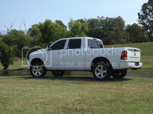

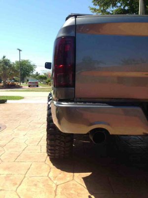

4" CST front - 2 " rear spacer from ebay ! and 0 offset wheels ImageUploadedByTapatalk1399255398.772510.jpgImageUploadedByTapatalk1399255452.375010.jpg

Nice truck man, that was my original color choice but I couldn't find any Sports in stock for miles and miles.
What size tires are they? Any rubbing?
Ram82808
Sep 21, 2013
257
101
they are 25x12.5 no rubbing AT ALL

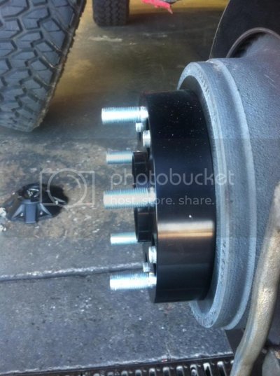

Here is a picture of a guy with a 2012 like mine. He has the BORA 1.5'' adapters in this pic. He had to trim just a little off the stock studs so the new rims would fit flush. Not sure on the stud size of yours, or if they are even the same length. Check these adapters out. They are hub and wheel centric, which is what you want. Not sure if the ones on Amazon will be the right fit, could be though.

I bought a pair of the 1.5" BORA adaptors. After doing a little research it seems that 13+ trucks have lugs that are longer than 1.5".
How the hell does one go about 'trimming' a lug?
012RAMbo
Jan 2, 2014
785
221
West Monroe, La
Put an open ended lug nut on the stock stud and tighten it down lower than where you want to cut it off at. Then use a bandsaw or sawzall to cut the stud. Then back the nut off to straighten out the thread on the end. Shouldn't have any trouble like that.
