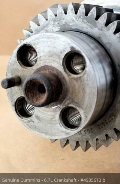

Pin for damper snapped and don’t have time right this min to drill out so does it have to be pinned 2016 ram 3500 6.7 diesel

Yes, it should be pinned otherwise the dampener could walk off the crank snout and cause some damage.

Sometimes in life you have to make time. Anything else right now is a gamble of that dampener slipping on the crank.

I thought it was 4 bolts that hold it to the crank? That’s why I asked.
