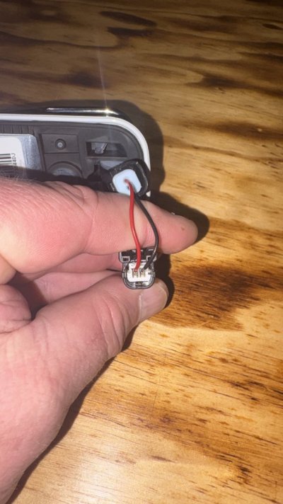

May have been discussed before but I cannot find it. What type of pin tool do I need to remove the pins from passive entry door handles on a 2015 Ram? I need to replace the white base with my black base. Any help will be appreciatedIMG_5277.jpeg

May have been discussed before but I cannot find it. What type of pin tool do I need to remove the pins from passive entry door handles on a 2015 Ram? I need to replace the white base with my black base. Any help will be appreciatedView attachment 578189

If you look in you can usually see the locking tab. You can usually fish in there & pry the tabs back with a small thin flat blade of something you might have in the shop (I have a piece of windshield wiper stainless steel that I filed narrow ...or a piece of welding wire (end filed at an angle). I've removed several pins from connectors with thin instruments I fashioned.
But yeah, if you want to buy a set ...probably won't hurt.

Appreciate it guys. I have a pin tool set but none of them seemed to work. I discovered that the chrome part of the standard handles and bases are slightly different (in my case anyway) so I have ordered 2 new handles in black.
