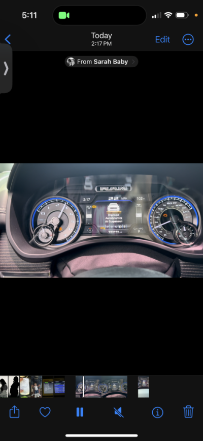

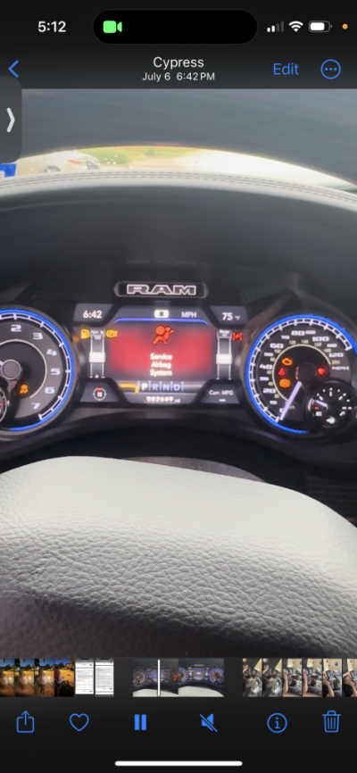

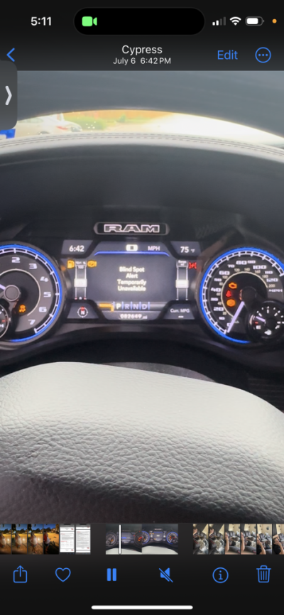

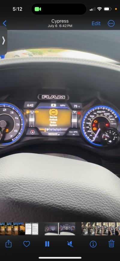

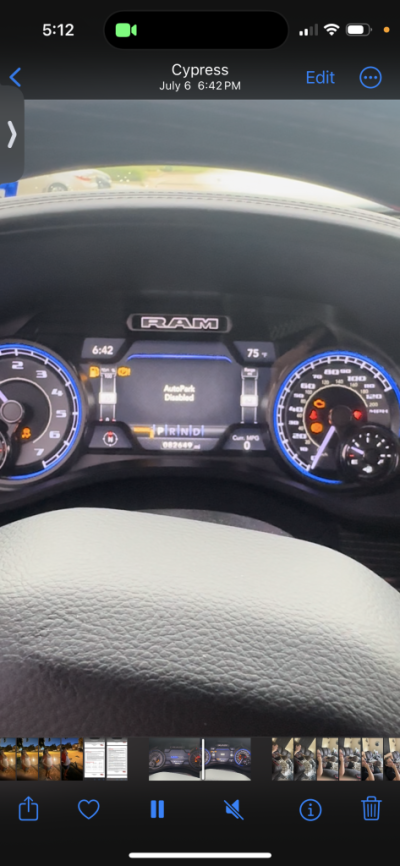

My 2020 ram 5.7 e torque limited has some serious electric issues that are worrying me like putting itself in auto park and flashing every code possible. When at slow speed 20mph and less or at idle usually after a heavy rain my pickup will flash every code imaginable
80k approx miles

Is the battery original? Not the 48V etorque battery but the 12V battery. These trucks are very sensitive with voltage and wild error codes and systems out messages are often caused by a faulty battery. Even a weak battery can start the vehicle so it’s best to have the battery and alternator tested, don’t go on the battery is fine because it starts the truck.

Thank you I replaced the original battery to a die hard platinum agm 850cca 1000ca and honestly ran great for a number of months. But now I’m thinking about going to optima battery. I think your right I think the battery went to poop

You could have got a poor battery when you replaced the old one. It happens so I’d suggest using the warranty and getting a new one. No sense wasting money on another new battery. Maybe you’ll have better luck with the replacement. I see you are in Texas, heat is really hard on batteries.

yeah extreme heat man. I appreciate your input. I am going to warranty the battery first
