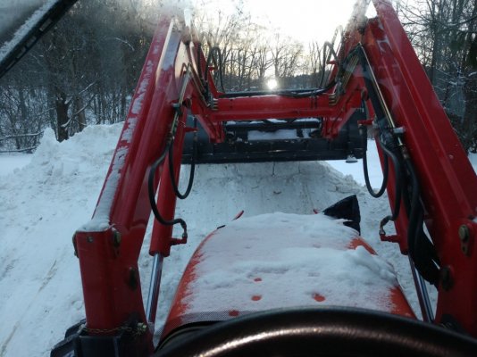

Agree with not using daily driver, it messes front end up. But everyone works plows differently with some hitting curbs and others just light snow and never hitting massive piles from past storms, so some people may recommend. I say pay someone to do it and save the cost plus wear and tear. Or get a Kubota with a snow blade and a box scraper to keep gravel in place. I am toying with that idea for 100' of pavement and 400' of gravel, but wife keeps catching me when I go to local farm dealer.

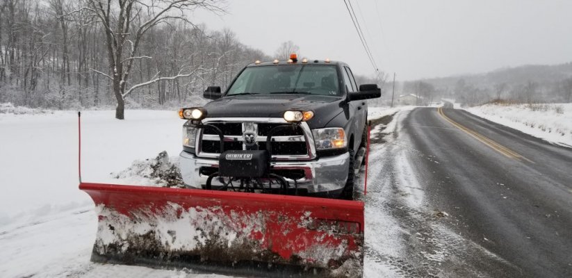

I plow in NY where we average about 5' of snow a season with my 03 1500 chevy if you don't beat on it you'll be fine only doing your driveway especially. I plow driveways and a couple businesses but try not to beat on it.
