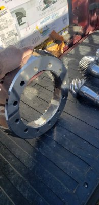

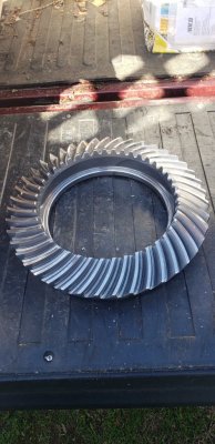

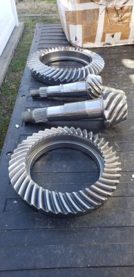

Well i bit the bullet and got my new Nitro 430s polished prior to install and it sucks these gears will never be seen. These things are a mirror finish. Guys at New England Gear and Polish did these right for me..
Hopefully the comments about noisy Nitro gears will not be an issue. And I am convinced that compared to the raw gears polishing is the way to go. Being that these gears are going in my dually with 6" lift rolling on 37" tires and pulls my 42' 5er I want to make sure I did everything posible to keep wear and tear to a min. 20210116_140630.jpg 20210116_140624.jpg 20210116_140619.jpg 20210116_140610.jpg 20210116_140606.jpg

I didn’t know this was a thing. Wouldn’t it change how the ring carries and sheds oil from the bottom of the diff?
