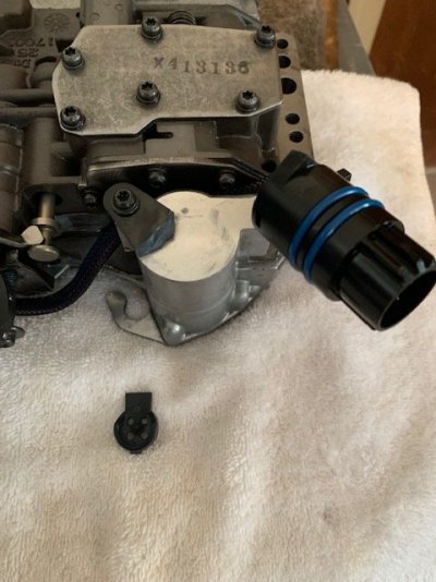

4. After you break the plastic housing for the TCC connector (pic #3) -- a few times @ around $70 a pop -- you will want to truly align the transmission for the park rod/plunger to position so very easily.

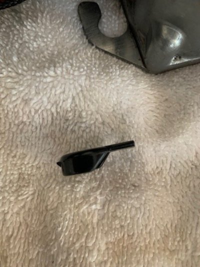

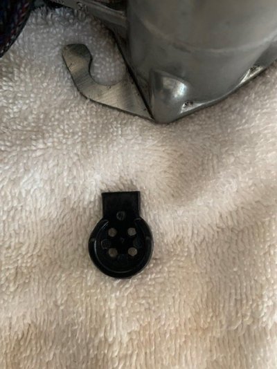

A. When I first attempted to put the valve body back in the transmission, and broke the TCC base, I found a small plastic piece lying on the ground beside me as I brought the valve body down. I have yet to figure out where this piece came from, let alone what the heck it does! Pictures 5, & 6 show it. it can also be seen in picture 3. Does anyone have any idea what this is and where it belongs?

Can't really say about that broken piece probably somewhere where the connector broke. a lot of guys like to pull the e-clip for the parking rod; however, I find that if you are rebuilding the overdrive section on a 2wd, one you DO NOT need to remove the whole tranny, just the tail section, next when you reinstall the overdrive section, you can place the drive shaft back onto the output shaft, and spin the drive shaft and the parking rod will engage. you can also lift the rear end off the ground and rotate a tire, it will go right in, The pawl engages about every 3/4" That how it's able to engage as the output shaft never stops in the same clock position. Now to the shifter. On your model, you have TTV so once you disturbed the valve body you need to align the selector switch to the shifter cable. relax, its easy on your model. go under the truck and ensure the comb is full in the park position, then go under your steering column and there is a black lock ring on the cable, that will come off by hand, right above that is a white lock than can be removed with your ignition key, screwdriver, etc. make sure the gear shift is in park and that will adjust the slack or lack there of in the cable. put the white lock back in and the black lock ring. this adjustment is important, for the throttle valve to function to its full potential. good luck
