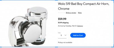

If not too small for your needs, the Home Depot Husky 12v working fine for emergency use on trails, keep it in a ammo box. 130 psi with gauge. Also have an loud electric Bad Boy horn, takes a relay.

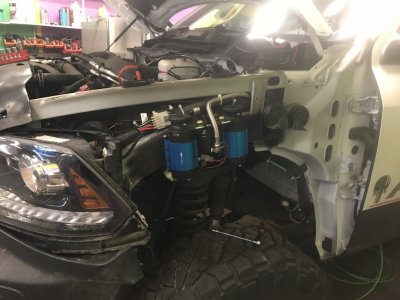

Here is where I put my ARB twin compressor ran a line down to a tank that I mounted underneath that holds about 5 gallons of air and I have an air chuck mounted in the hole on the right rear of the bed inside where the tiedown is compressor is completely protected from the elements and works very very well

Very Professional, I like it!!!!!

Can you access the filters for cleaning?

FWIW, You can extend the air compressor intake. I did this with my Taco. It has 2 ARB compressors onboard, a twin for filling up tires and what not, and a smaller one under the hood dedicated for F&R lockers. The front one was in a place where the filter was not in a favorable location so I replaced the filter with an 18" stainless leader line that then went up and into a standard filter that was tied into a corner where it stays "cleaner" and I can easily clean it out.
Long story short, you can relocate the filter rather easily.

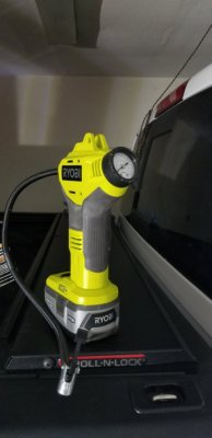

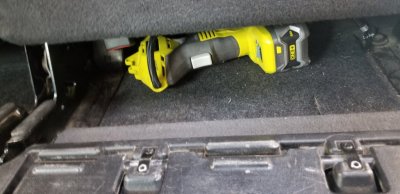

If its just for tires I have one of these. Its a bit slow, but gets the job done. The lithium batteries have a guage on them to show charge level and have the same battery as my cheaper impact that I keep in the truck as well.will fit on the floor behind the seat.15497379925023045182488932853108.jpg 15497381115842964205696059195584.jpg
