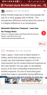

I had a killer deal on a used moes ported TB, but my truck is a 2010 and the electronics wont work. Has anyone here dynoed their truck before and after? Reason i ask, is I added a cai, bjgger TB, and gained zero rwhp.
I would like to see some proof before i drop some coin. I want to have everything i need before i get a custom tune from greene. Thanks.

Yeah all i have heard is better throttle response, and almost no HP gain. The 5 hp that was gained wasnt much considering it was a new Z06 vette. I didnt expect much of a hp gain just by adding 5mm to a TB. So on our motors we would be lucky to gain 1 hp. Iooks like I will save my money for a cusom tune from greene.
