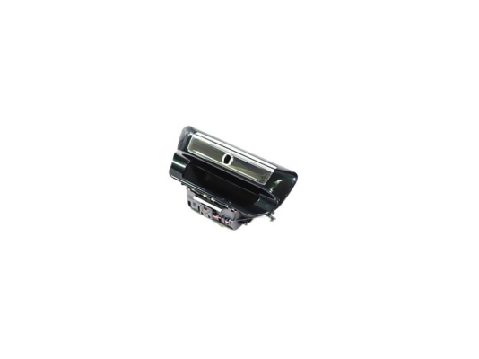

Unless i read all this wrong
It sounds like the 5th Gen Rams have 2 different tailgates
One has a tailgate handle release mechanism & the other does Not ?
I believe you are correct, they offer the traditional and the multi-functional tailgates. On my 2022 I ordered the multi-functional tailgate, it has touchpads for releasing either the drop-down or the barn door and it also unlocks the tailgate (if locked) if the FOB is sensed. I don't know if this is standard on all trims but this is how the multi-functional operates on a 2022 Longhorn.
You are correct and wrong LOL. You're correct that there are two different types of tailgates. The traditional and the multi-function tailgates. But both use electronic buttons to release, and there is no mechanical release mechanism in either version. The reason for the two different handles is the MFT version needs two different release buttons, while the traditional tailgate only has one button.
