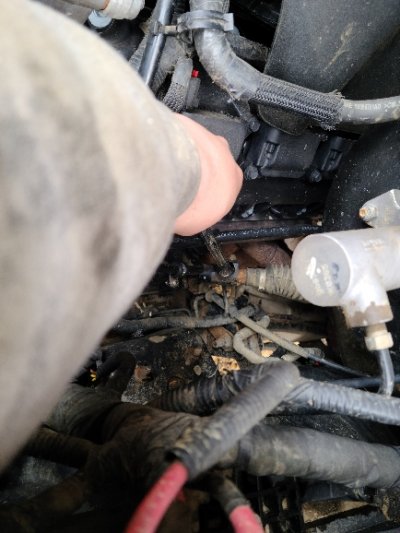

Any bind or lumping in the joint you'll feel it 10x worse in the wheel.
Bunjee your steering wheel straight so it can't rotate and disconnect this shaft and check. 1d3325323a2fed6d82f72eefc4a25e6c.jpg
