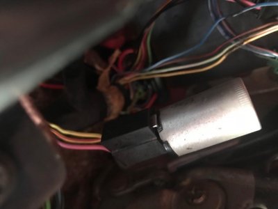

While installing a new headlight relay switch, I came across this thing. I can't determine what it's to or what it does. It's very hot and the truck has not been on for 3+ hours. Could this be my problem?pic.jpg

nope that this is not the issue. it only gets power when your doors are open. it usually keeps the key light on for a few seconds after you open or close a door. your issue is most likely a faulty switch. there is a built in circuit breaker in the headlight switch for the headlights.
