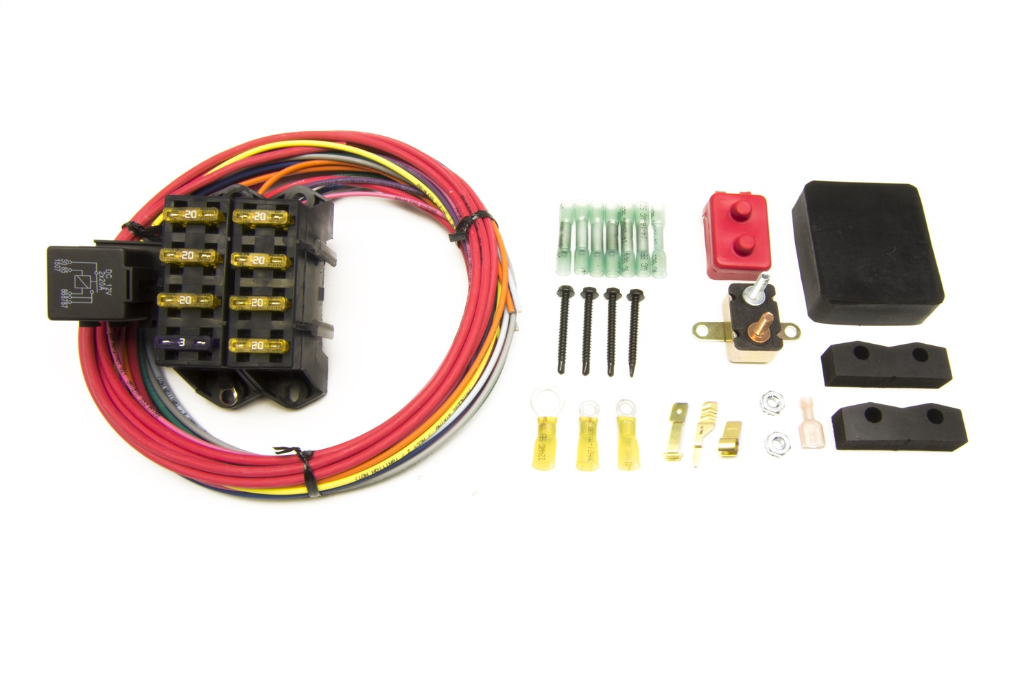

Wondering if there is a PDB that I can use mounted near my battery that I can power a future Amp and possibly 2 other accessories rather than having several power wire eyelets bolted onto the battery itself ? Any suggestions?

It appears this is called a bus bar..a remote off to the side of the battery unit that allows a clean power attachment area for accessories..anyone have info on this unit?...thanks

Thanks Dinky..guys that is what I am looking for to power after market Fogs, Light bar and Amp...on switches in the cabin..

Take a wander through Princess Auto Dave,they have some stuff that might work for what you're wanting to do.

Blue Sea Systems ST Blade ATO/ATC Fuse Blocks https://www.amazon.com/dp/B001P6FTHC/ref=cm_sw_r_cp_api_glt_i_MDNXP34YWD995EA99D18
InstallGear 1/0 Gauge AWG In-Line ANL Fuse Holder (100A) https://www.amazon.com/dp/B07D1BMSW9/ref=cm_sw_r_cp_api_glt_i_J722YFMMEWM5E910KP68?psc=1
I’m a big fan of these, used them several times! To use it for fogs etc wire everything to it in the engine bay and I usually use 2 or 4 awg wire for ground and hot wires run to a 40 amp relay attached to an accessory circuit so that the whole block shuts off with the truck, as well as an inline fuse Like the second link. Just keep in mind the max amp limit for whatever block you buy- I believe this one is a max of 100amps per block regardless of how many circuits are used
