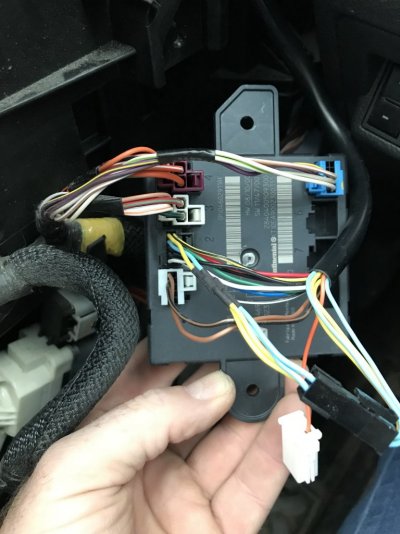

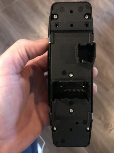

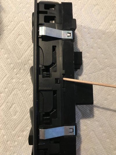

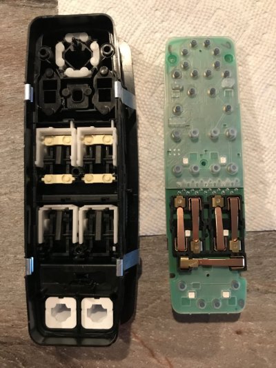

Hello all,
I also have added power folding tow mirrors to my 2011 Ram 3500 SLT. There are lots of useful information on this web site, i would recommend searching.
Everything was plug and play, used Alfaodb to "set" power fold option. Used a door switch out of a 2013 Ram and switched the cover, as i wanted to keep it with green back lite switches not blue. The 2013 switches have the trigger button for the power fold.
It was a fun little mod to do, took a couple hours. Most time was putting the switch back together. Need #9 torx bit for the screws on the back of the switch.
Modules:
Mirrors i picked up from Boost. They can modify them with a few extra features. Different light options, dual heat ect. Big bonus is that if this did not work there is a connector that can be used as a trigger for the fold option.
Send me a PM if you have any questions..
Thanks to everyone who contributes to this forum..
Kevin.
