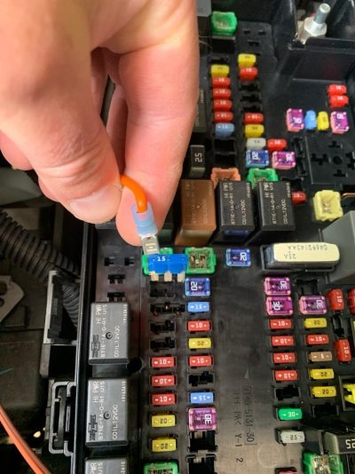

So under the hood on mine it is marked F90/91 it’s a 3 prong micro fuse (plow installers tapped it). Not clear to me how I move it between as there is no other slot that it would fit.b3e1dd8b9bcb670e80dfbf7b02ef7f58.jpg

90 & 91 share the middle slot
However, on my 2020 90/91 change the USB port #5 serving the rear seats. Has nothing to do with the cigar lighter.

It definitely does on mine. It’s dead if I pull it. I’m wondering if I stick a micro in either side if that’s the select ?
I would assume so. What would you do with the wire using the 3 prong?
I've never seen a 3 prong fuse before. I can't advise you as I have no idea why plow installers would use 90/91 and that type of fuse.
That's a new one to me :mad:

Well that was it, took out the three blade and put the two blade micro 2 one in and that was the trick. I’ll be calling them Monday but I’m assuming it was for the controller. Why a 3 blade 15amp when the factory specifically asked for a 20 is what baffles me still. Thanks for everyone’s help!
That's all good news. Yep, my 2016 also shows it as a 20amp. I'm sure so it can handle anything you would plug into it.

YES, 2 bladed, in 1 way ignition, forward (other way) battery...
That is 1st time I have seen a 3 bladed fuse like that also
ADDED: U prob gonna have to get power to the controller on yer plow I guess. With that 3 prong in there, it was like jumping circuit on both sides. But I cannot say which side to plug in, U gonna have to use a tester and determine all that and figure out which position the 2 blade for Battery/or Ignition, but from how I am reading yer post, I think U have. Now U gotta get power to yer controller.
