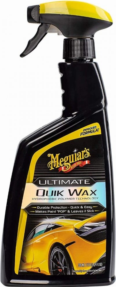

If you want to "fill" those fine scratches. Use Meguiar's Ultimate Wash and Wax.
Dry the truck with a chamois (sheep skin is recommended)
Wash it and dry it again <-- Don't skip this step
Then spray on the Meguiars Quik wax and wipe it off with a microfiber (do one panel at a time)
Otherwise, plan B, which is much more costly:
- Flex XC3401 polisher with Meguiar's Compound with a Lake country Yellow Pad
- Meguiar's MT300CC Polisher with Meguiar's Finishing Wax with finishing disc
- Wax of your choice
