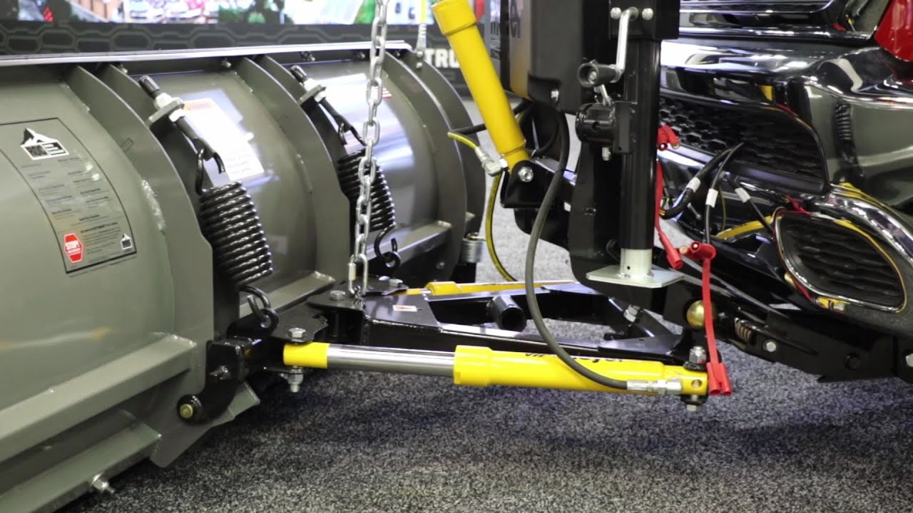

Which company makes the Snow/Rock Plow ?
Get their engineers on the phone or Fax, surely 2022 is not the first year of the Active Air Dam.
The Active Air Dam & the AGS, ( active grille shutters ) , both do the same thing, supposedly they give you a tiny bit of better fuel mileage.
( not all 2022 Rams have the active air dam, so it is not part of any kind of State or Federal Emissions Test )
People have been bypassing the AGS for several years now.
There is a way to bypass the Air Dam
Look around on YouTube for an answer
GTyankee
Nov 2, 2020
12,391
17,460
El Cajon Calif. 92021
3.0 ecodiesel
this video explains it a bit clearer
This video was made by RAM & it is about Snow Plows
Your company that sells plows, SHOULD know all about it
