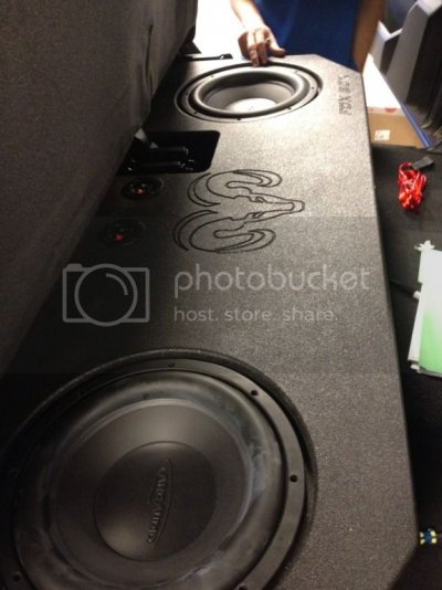

I think it sounds pretty good! My favorite sub in this enclosure thus far.
But Iam after sq, not output.
Its very musical, very rich, blends well with my front stage (depending on my levels)
and yea...I like it alot for now lol
I didn't have the time to build an under seat box, but I will eventually pull the trigger on a center console enclosure, front foot-well enclosure, or a simple box behind center console for a single 12"...I have not decided yet, and I may be in the market for a new truck so Iam simply enjoying what I have now.
It get really loud for those specific times, but the Blacks are very gentle as well...they almost disappear which is good.

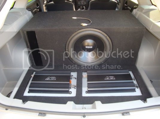

I had a magnum with a ported 15" (SSA Icon) and then switched to 4 - 8" (Image dynamics) sealed. both off of about 1200 watts. I knos its comparing apples to oranges but the out put was way louder with the 15 and the 8" were way more musical but still killed the lows and still plenty of output.
because I like to show off...
cant believe I don't have any pics with the 8" finished
ever since, ive never had another ported enclosure and have never been dis-satisfied. Enough airspace and power will allow a sealed enclosure to pound

Boom and brad I hope you still have those AQ amps around they are kinda the best bang for buck ever.
BradKnob
Mar 12, 2014
1,382
395
Prairieville, LA
Wish I did and ur right. For the price, those were hard to beat. Loved that setup. If it would have fit, I'd have an icon in my truck right now. One of the best SQL subs I ever heard.
