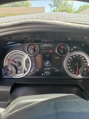

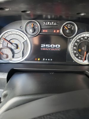

So i been checking these out for awhile now and decided to get hold of the cluster surgeon and get me a premium cluster for me 17 tradesman ram 2500
The swap was super easy and so far everything seems to be working great
Before & after

Did he add the 2500 start up also?
I would like contact info also.
You can change that with Alfa along with programming idle and drive hours. I’m going to assume next update for Alfa will be for mileage correction for our premium clusters.

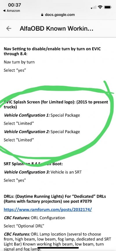

It’s in this screen shot below. You need to change both special package settings to the same option. There is a long list of screen start up options. Mine personally is Lonestar. Just go through the list and pick the one you want. I don’t know exactly what the 2500 option is called. But you can try them and see the ones you like or dislike.
Note not all of them will work.

So they are all pre selected you can't build your own??
No they are pre loaded into your cluster by the manufacturer. Unless you can go into the cluster yourself and add files/splash screens you won’t be able to do custom ones
That’s why you can only use certain options because if it’s not a preloaded splash screen it won’t show up and I believe it just faults back to the Ram splash screen
