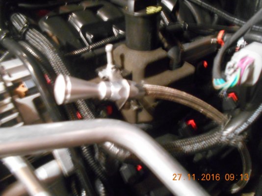

Guess once it's in the garage and I dig into it I'll be flipping a coin. Originally I was leaning towards pulling the motor and doing it on the stand but might be more efficient to just do the work in the bay. Whats the deal with oil dipstick fitment? I've read that it fits with small tweaking, and also read that I'll need to order the Lokar flexible dipstick. But also saw a post about the Lokar one being too short and maybe getting a custom ordered one that was longer? One says it's 24 inches, the other doesn't say. So is the 24 the longer or shorter of the options?

The 24 is the longer off the shelf version,it'll reach over to the brake booster,which is where alot of guys bolt it to.As far as i know,i' the only one running a custom 31" Lokar dipstick,but it appears it's hard to get one these days.Mine reaches up to just about where the original dipstick is located.If i was doing it over again,i'd have it made 33" or 34" long instead of 31".S hitty pic,but you can see roughly where it sits.If you feed the dipstick back into the hole,before bolting the drivers side header on tight,you can usually get it back in place,then bolt the header up tight,and bend the dipstick tube to where it's not touching anything.

If you ever think you'll pull the dipstick tube again, cut the lower mounting bolt down now ~1/4“. There is almost no room to get that bolt out & in with the mount in the way. I ended up tweaking my tube a bit to get it in with the headers. Took about an hour of trial & error. In the end, fits good & dipstick doesn't have any extra resistance. I cut down a factory manifold bolt to reuse the upper mounting tab.
