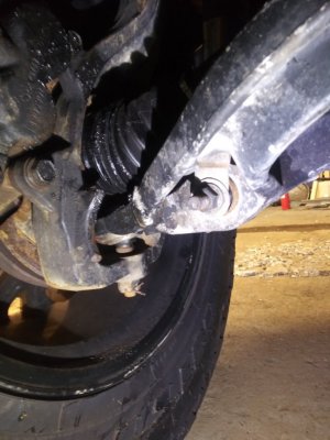

I put the pro comp 4" lift on my 2015 ram. I had it aligned and the shop told me that there was no way to adjust the camber.
Would this be a true statement?
I plan on taking it to a better shop as I do not drive it allot but just looking for info for right now.

Firestone told me the same thing. Took it to an off-road shop and they got the alignment done. These trucks adjust off the lower control arm and a lot of shops don’t “see how to adjust it” because they don’t see/use the rear adjustment on the lower control arm. I printed out a “how to sheet” just in case I have to go back to firestone anytime soon. I have a lifetime alignment through them. They told me I had to get adjustable ball joints because it was maxed out... checked myself and they hadn’t touched the rear adjustment
