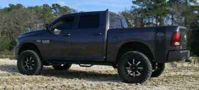

Im currently running a pro comp 6 inch with oem shocks in the front. I saved a nice dime when i purchased and installed last year without upgrading to the coil overs. The ride has been great and tire wear great. currently 35x12.50 nittos
I now want 37x13.50s . i currently have 43.5 and 44.75 front and rear distances. My gap seems large enough for 37's bu t i was thinking of adding the bilsteins or pro comp coil overs to hopefully achieve a little more height.
Does anyone have input or thoughts on this. I hate listening to shops, they are always biased in favor of making the most money.
Thanks for any input.
2015 sport , 8 speed . 3.92s being installed this week.

The height isnt the issue. The 13.50" is.. Check on procomps site and see if they state any sizing/wheel specs.
You can clear 37x13.50 at the fenders.. Just may need more backspacing to clear the knuckles.
Most of the popular lifts recommend 37x12.50 ... Which limits you to certain brands.

Need to know your wheel specs before we can give you any solid information. Tire size without wheel specs doesn't mean much in this application.
