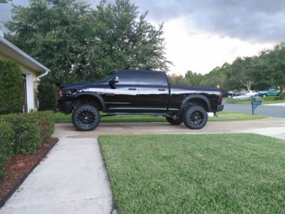

Not sure how they compare to bils since I have always had these. I am happy with the ride though. A few pics. As I stated, I have a slight squat which can be corrected, but the pic at the bottom here where it is on level ground, you can see it is really not noticeable.

Is it just me or are those CVs at some major angles?
Yeah they are. About 12k miles since I flipped those collars and about 36k miles when the collars were set at 4" lift. Im kinda surprised I haven't had to replace them yet.

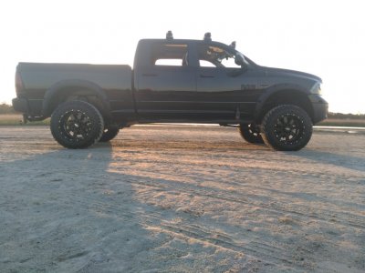

blairwilder97
blairwilder97
Nov 5, 2017
50
Thought I would post a updated photo of my truck with the new parts! Love the pro runner shocks as they ride smooth and they gave my front end the 2 inch face lift and changed the whole look of my truck!
