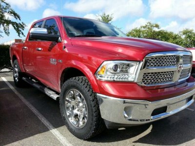

Here you have it guys. The final product. My free tires and level installed! Truck looks totally different IMHO. No wheel spacers needed using the stock rims surprisingly enough. I fit 35 12.50 20 General Grabber AT 2.

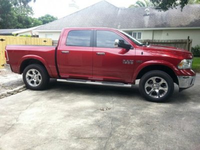

Here is the truck stock and after level. Anyone on the fence about doing this, get off it. Its fairly inexpensive and really improves the look of the truck while staying mostly stock.

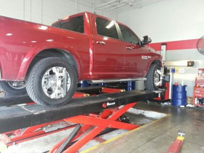

Thanks! Ill try to get you a better pic from the side. Its getting the alignment as we speak. The width is the only issue. If they made a 36 11.50 it would fit IMO. The tire just barely clears the control arm on the inside and has a slight rub at full lock. We will see if that's still the case after the alignment and subsequent camber adjustments.
