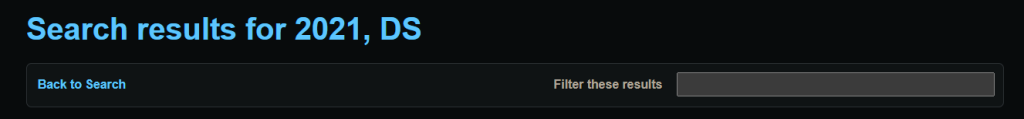

The following link is sometimes helpful when chasing connectors in the harness.
Use the 'Filter these results' box to search keywords like brakes, CHMSL, etc
